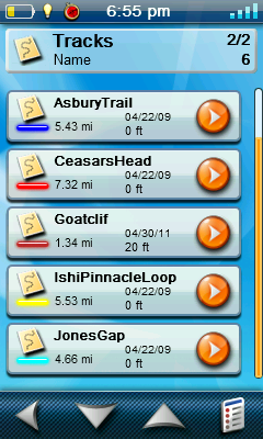

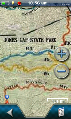

Here is VP with gpx trail files loaded and the custom overlay map active that has the area trails incorporated on the map image.

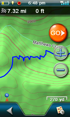

Here are a few screenshots on the 710 with the trail files loaded. Also showing them with the rmp map active and without.
This is one of my trails with a MOBAC aerial map active
The .tpo trail files were downloaded from localhikes.com. Then converted to .gpx with gpsvisualizer's online tool. Imported these to VP then added them to the 710.

Trails within state park areas are not typically part of map data sets. Many of them within national lands are. You can usually find trail data or trail maps of state and local areas by searching on line and then using that data and converting it or incorporating it somehow into your gps unit. Here is an example of the area you are looking for. Shown in Vantage Point and on the Ex710.
